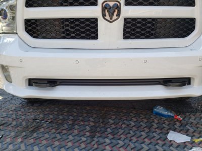

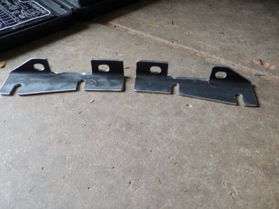

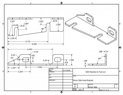

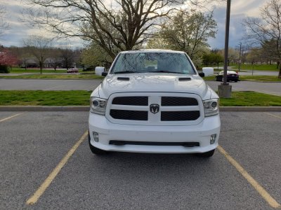

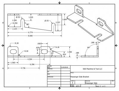

First and foremost, thank you to those that have already done this mod and shared the details/dimensions for the custom brackets, they worked perfectly!

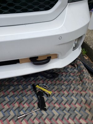

I got the hooks for free from a friend, and used the dimensions posted on the forum to have brackets made and powder coated at work.

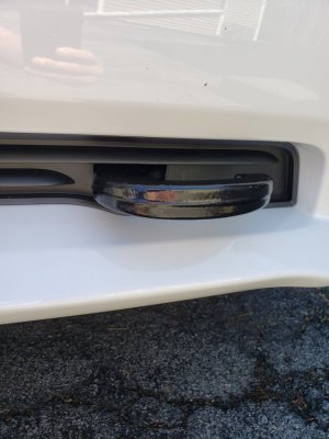

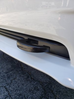

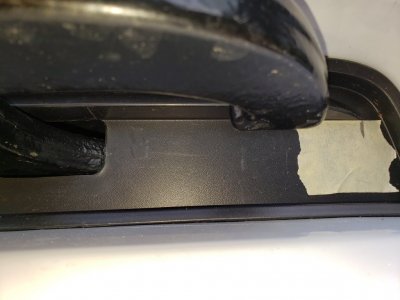

Took my sweet ass time test fitting, measuring and cutting out the lower bumper insert for a tight, clean fit.
Overall I am very happy how it came out.
My ARB recovery strap slides right on with out touching any paint. Going to pick up a Gator soft shackle to be safe.
