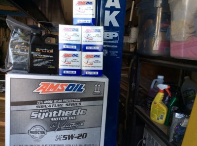

When it comes to oil changes I’ve always stuck to 3k even though the oil may be capable of 5 or more I believe the average filter isn’t,no matter what anyone says. My ram had the oil dumped at 400 miles and my longtime fav put in.But I treasure the few times I’m in charge of the break in
And no archoil till 3k
