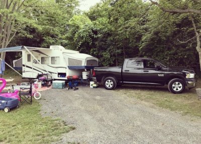

Honestly, I tow this guy, and it does fine. Just stay out the 7th and 8th gears. Don’t fear Higher RPM.
