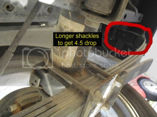

OK. If you are trying to piece it together you will need the longer shackles with to go with the flip kit, like these: {Not the short shackles!}

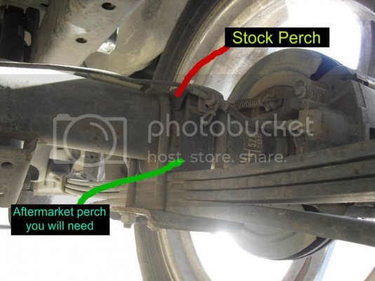

But you will also need the perches for the leafs to be on once you do the flip kit like this:
And here you can see the shackles I have are longer compared to the OEM ones which is what you'll need to get, don't get the short drop shackles

On Dodges, once you flip the leaf spring under the axle, you need a longer shackle, if you keep the OEM short ones, you will get a 8" drop or so.
