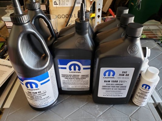

I read this thread and a million like it over the last few days or so. My head was spinning.
Anyway, I just did all the fluids today except the coolant.
I went with Mopar oils for the front diff and transfer case. Valvoline synthetic for the rear. Pennzoil for the Hemi. Spoke to a few parts guys at the Dodge dealers I deal with as well as a mechanic at a local Jeep specialist. They all said I should pony up for the front diff and Transfer case fluids and use Mopar products. I have the B44-44. The rear diff should be good with a decent full synthetic.
Still pretty expensive.

Just curious, did they say why?
Also did you use the 75w-85 in the front diff? If so what was the part #
