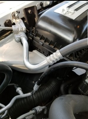

As far as your post I HAVE noticed on my earlier truck the plastic air tube was loose fitting against the fender seal. Kind of a crappy design of the fender to airbox tube. I wasnt happy with the seal so did some creative home depot shopping to find some thick weatherstripping so the tube actually compressed the seal with minimal gaps.
I never had a whistle/whine just thought it needed my attention
Edit add,.... I dont like the way the tube just pops into the aibox with the little nubs either but couldnt come up with a solution so left it alone

Just looked for a pic but this is as close as I have.
Added I THINK? a 1/4 " to the tube flange so it would hit and seal to the oem seal.
