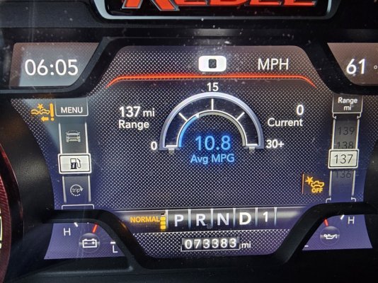

2021 rebel. fcw lights came on on my dash. i went into settings and tried turning on/off. lights still on dash. went to dealer for a recall a couple weeks ago and i asked about it, they looked into it and said repair can be upward to $2,000. anyone have an issue like this they were able to fix for... "cheap?"

I dont have ACC. I had no work done to the truck at all (except for routine maintenance). It just stopped working out of the blue
