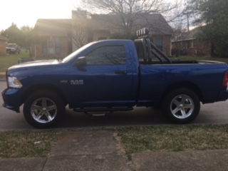

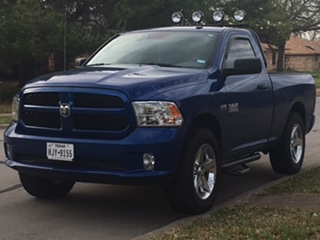

I have a 2016 1500 RCSB with Fox 2.0 set to perfect level with rear. I have stock 20"chrome clad wheels with Nitto Terra Grappler 35x11.50. no rubbing, no issues

Thanks jhal it looks real good how do u like the 2.0's?
