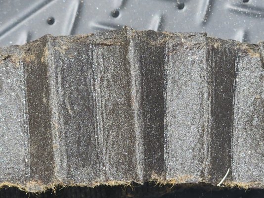

Fram FE2 cut open, from my 2015 1500 SLT with possible early lifter failure.

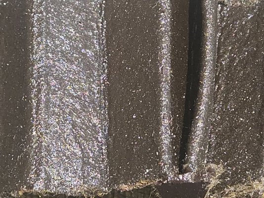

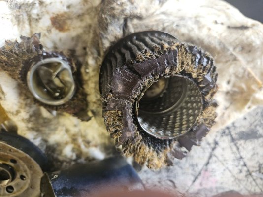

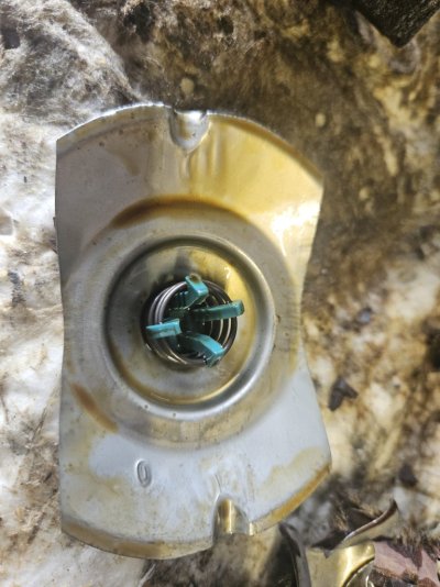

Decided to cut open my FE2 from my last OC about 1 month ago. 10k miles on the oci. Pardon my crudeness, I dont hav a fancy tool, so the hacksaw went to work:
I should have sawn it closer to the top.
Filter media, it is potted into the top and bottom cap:
Had to peel the top and bottom from the media:

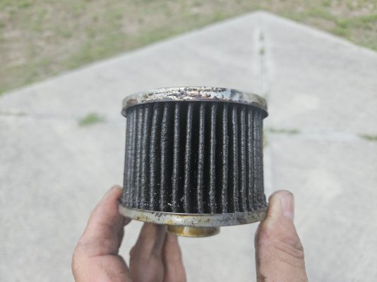

ADB:

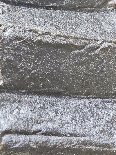

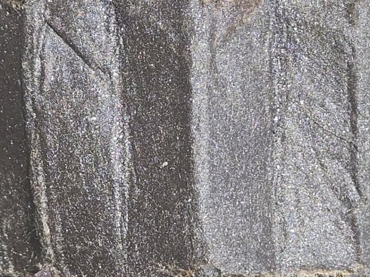

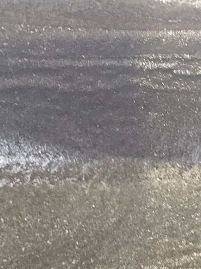

And now, the stretched media:
There are some small metal flecks, but some are from me hacksawing it. Still there is some metal in the folds.

Thanks for posting. About all we can tell from can cuts is whether the media failed, and this appears to be stoutly built.
But boy, is that media permeated. Would be interesting to assess at what point (mileage) it clogs enough to pop the bypass valve.
I feel much safer changing the filter with the oil ever OCI 5k.

I changed my oil religiously according to the oci, except when I first got the truck at 28600 mi. The Honda dealership where I bought it had a 5k interval sticker on the windshield.
Penzoil platinum 5w-20 for several changes, then went to PP5w-30 ever since. Been using the larger filter XG2 since about 100k, with the FE2 for my last 3 or 4 changes.
Made it to 201,000.
From here on I will do more frequent changes, possibly even some Redline, if my wallet permits.
