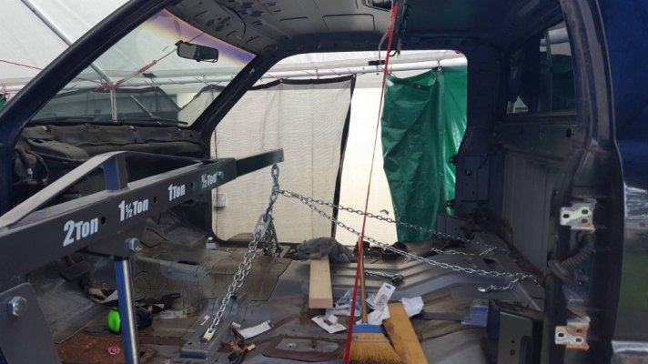

Had my helpers remove the cab bolts today. Also removed the hvac unit and passenger doors. Looked over everything and I am pretty sure I've disconnected all the wires and hoses that I needed to. Just need some saw horses and I can pull the cab.bd56adbf3ce2ef326fe2376c7634a4a0.jpg10245cf7e841d7fcfecd25ba95293889.jpg

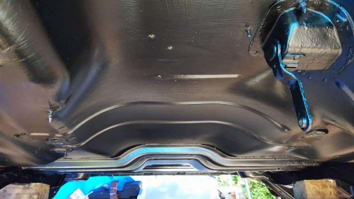

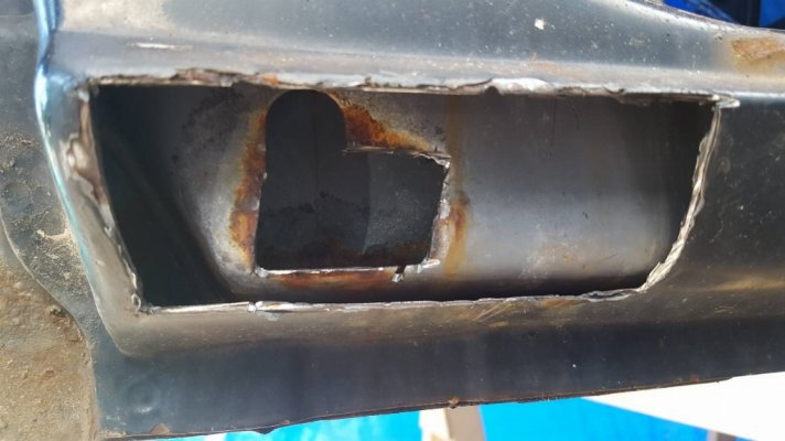

Painted the bottom of the cab and the driver's floor. Have a small rust repair to make on the driver's side rocker0ba0afd587590ff00a182b63edef56fd.jpg5af0638c39e1df4c69cb3c9e64e9ff5f.jpg341c0937ff82d207c455a1f6dca5653f.jpg

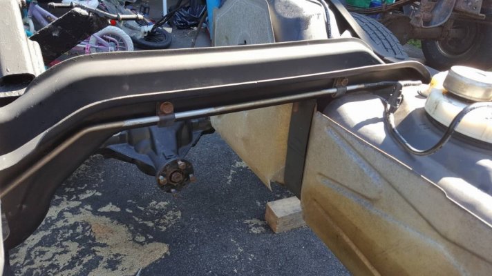

The metal clips for the fuel line that runs from the tank to the vapor canister were rotted away. The holes were the perfect size to use some extra bolts and plastic clips to mount the line.
Also mounted the track bar and bracket. Had to drill a hole through the bracket so that I could secure the brake line since the bracket covered the existing hole.
Started mounting the steering box and brace, should have that finished tomorrow and will snap some pics.f6fd20539a875209231d49305b26ab97.jpg67dcefdefc1123f8044b5705617bd0cb.jpgfa3074c1e5087686cb2e70e7cc7eaa29.jpg46da696efad44f6695ccbf40f858cce2.jpg

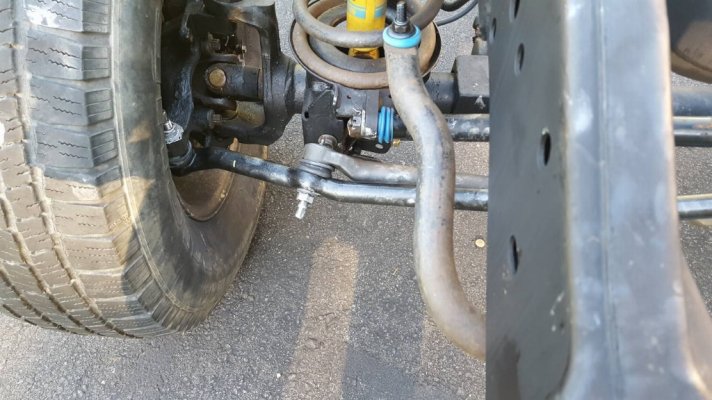

Got the steering all hooked up and the stabilizer bar installed3b75147c3161dc795dbfd599e20c9608.jpga096fe72f3dea21db5ce9219b36cde77.jpge2eda26387e2076a58a78fd30af7bdbc.jpg345668311363647ee5c8b5a3f593cf92.jpg

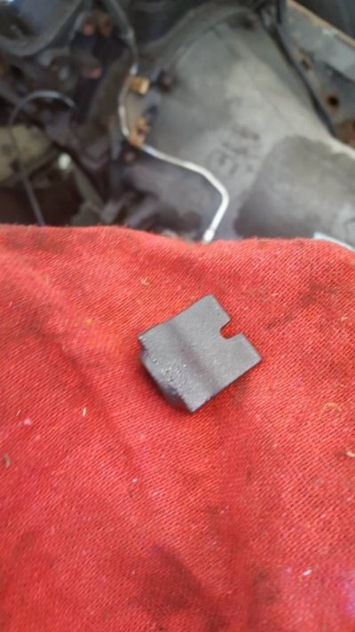

Here is the reason I had to stop driving my truck. This little guy fell out again. The first time I paid a shop to fix it without realizing how easy of a fix it was.ddd4dfb379f4b0dd01fb0d3c492f0224.jpg

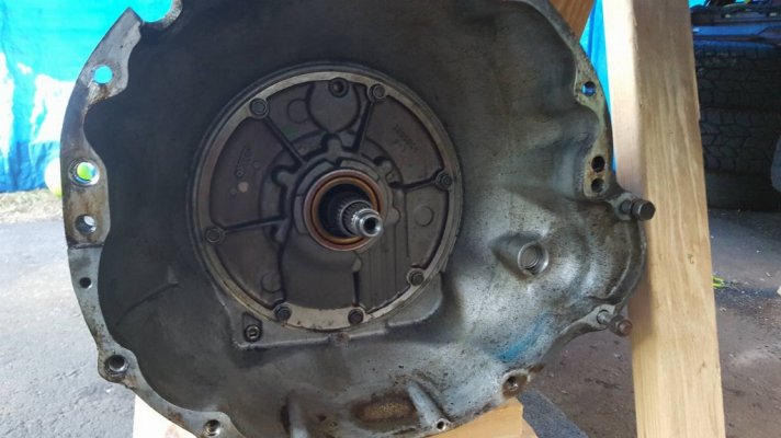

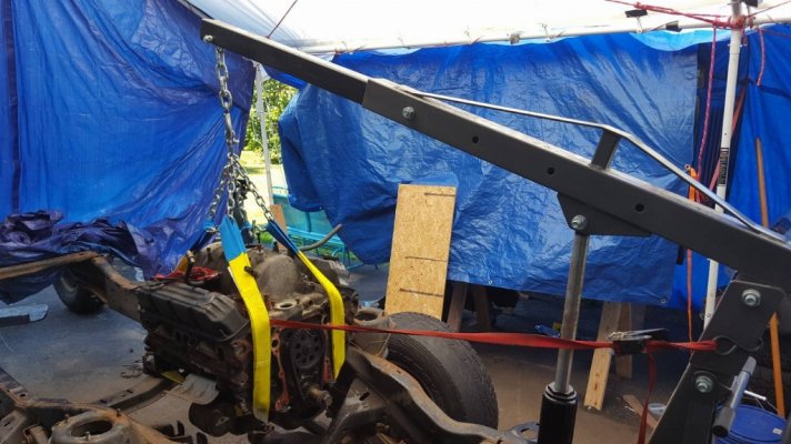

So I got the engine moved to the new frame on Sunday. Also, managed to break the screen on my phone which is why I was unable to post anything earlier. Have some more parts showing up soon. Hoping to get a lot done over the next 7 days 608eb8818c220c6675f5b9cec0ba425c.jpgc8783b9447eb5037658768637bd6f992.jpg0ac9f8b66522bcad77aa0314f3da4db7.jpg

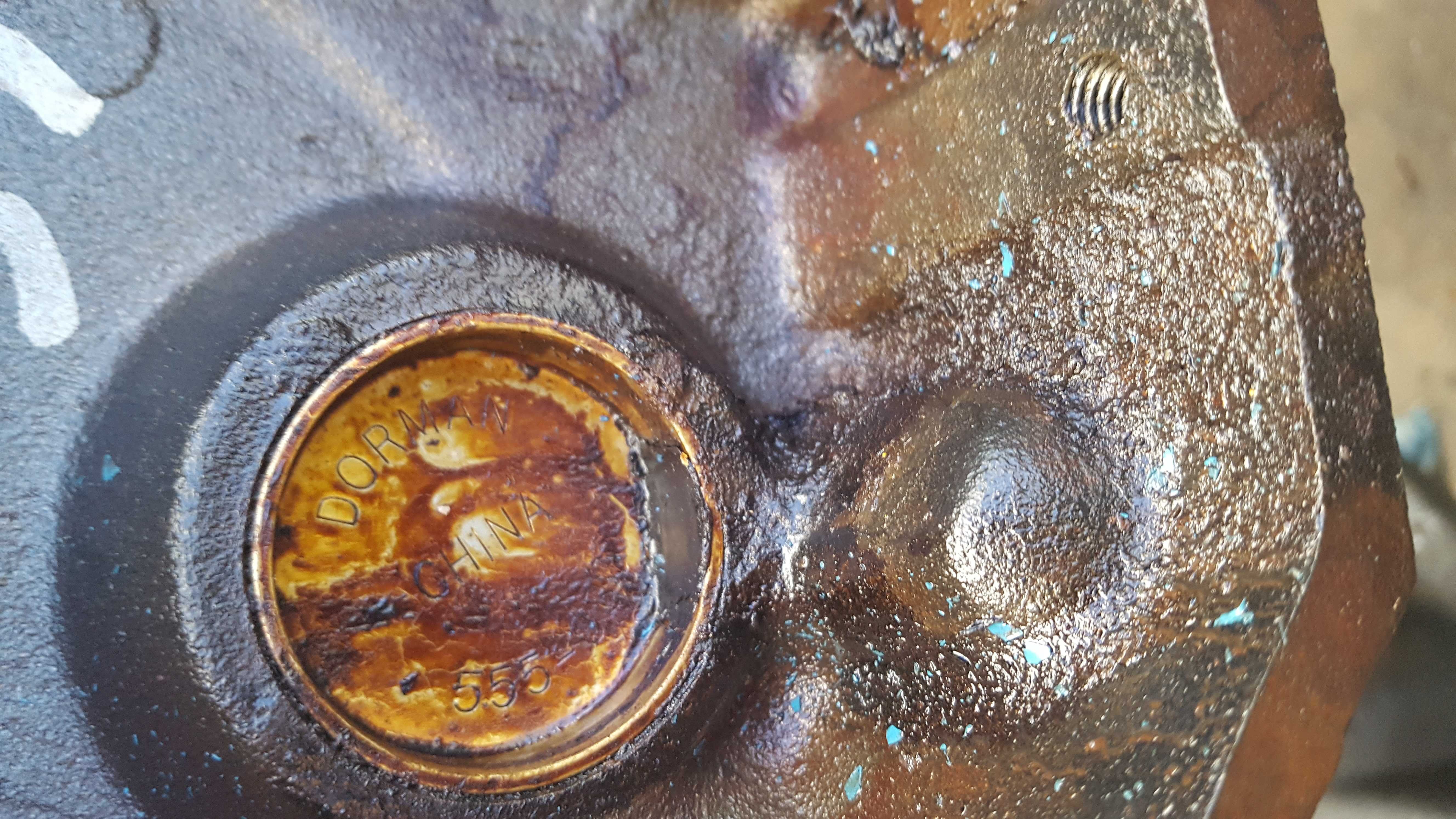

If it were me I would go ahead and replace the head gaskets and plenum gasket while I had easy access to everything. You should also inspect all of the freeze plugs as well.
How would I determine if the freeze plugs need replaced?
Sent from my SM-G920P using Tapatalk
Gr8bawana
Dec 7, 2015
1,274
1,059
6.7 CTD
In your pic looking at the rear of the engine the freeze plug on the left looks rusty. It would really suck to have it leaking after a couple of months with all your work. You can get a kit with all the freeze plugs from RockAuto for less than $15.

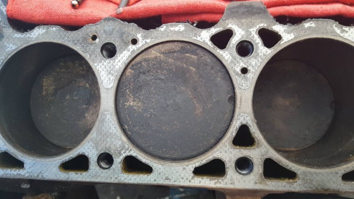

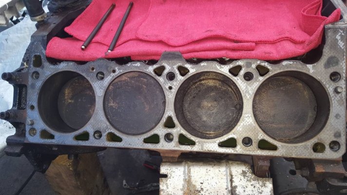

Got one head off. Cleaning off the old gasket and going to try to clean up some of the build up on the piston.98bb28a89e85fb88b04e283066785a26.jpgd05cf3fd348e4e58bcebf0d9d0843c72.jpg

So the 2 on the back of the block look like they were replaced at some point. Will probably just replace the others to avoid any issues since a few look kinda rusty
