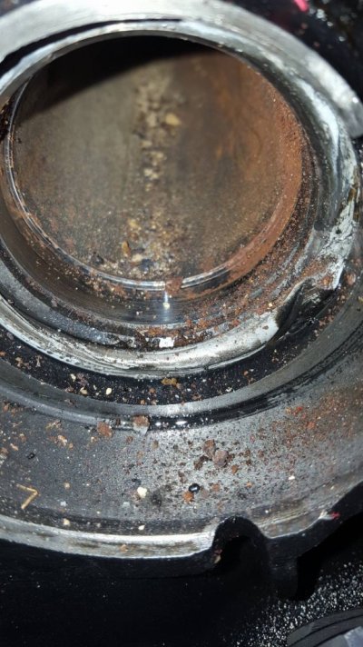

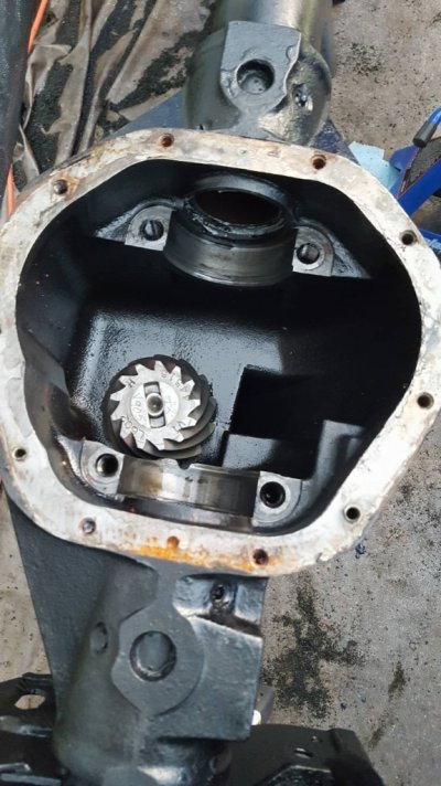

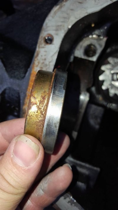

Replaced the seals in the front axle the yesterday. Removed the carrier, took a piece of 1.5" pvc pipe and knocked the old seals out. Went pretty quick.75b98afde521debd56094bd50450f435.jpg62b68afe4a2f8a4e86d1cad0088deb84.jpg8aaff92f3f319790da873b229cbf932f.jpgf007517fc0d02eab24cc4390c3d8dc6e.jpgf84a20e5f38dd3c3694069a0fa123a77.jpg2f1e64976e618a97f7cd24426ea79b95.jpg5222bba7e26a90e4b3d40a2b2bef093d.jpg

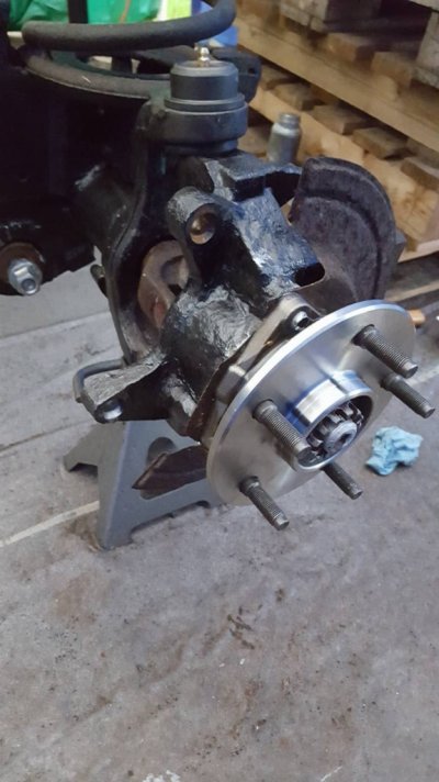

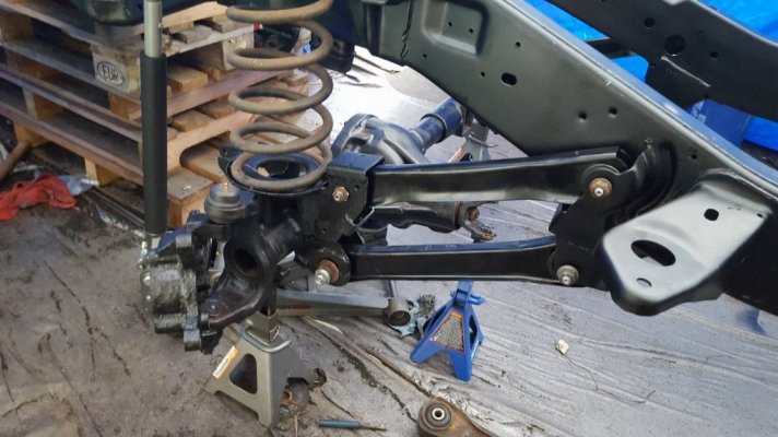

Got the ball joints installed and put the control arms on. Getting close to putting her back on 4 wheels. Just need to get the brakes put ondd704020929b24dc09cbd4d3f8af55df.jpg7a33bfd78a7e4071a0bc088d8081b2e2.jpg

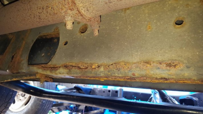

This is why I started this project. Once the bed was off my wife even commented that she could see why I was doing this.d032b3dca1e2c4f15b22a737c78ec94d.jpg9d3fa229491a5d5ce60a430566349c20.jpg939ea852a508b4ab411637e735c80be1.jpg322bb15df0aff7267c90200808f7dd05.jpg3acf8fba27399776b30e9e0bf8f2cb30.jpgdeac1982753b5ea7495f759544b53f3f.jpg

Found out some good news when taking apart the axle. This frame was from a 2000 and not a 99 like I was told. So much to my surprise I have dual piston calipers.
The lower control arms were the only difficult part so far. Wasn't expecting them to put up a fight but, in the end I won...with a cut off wheelhttps://uploads.tapatalk-

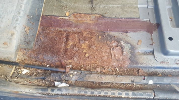

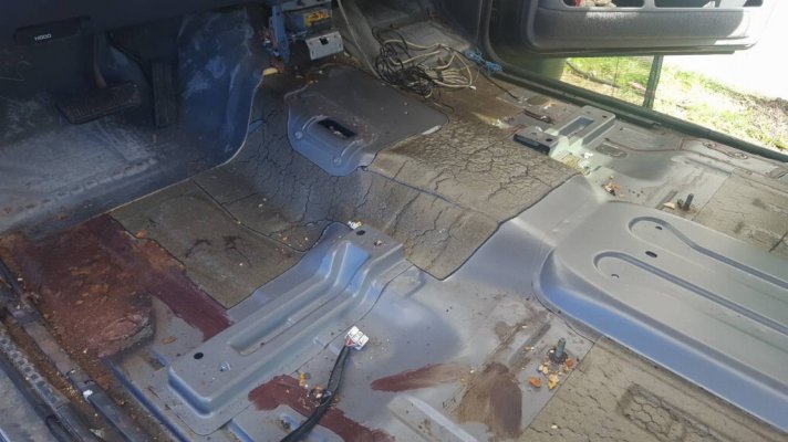

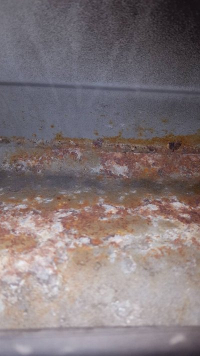

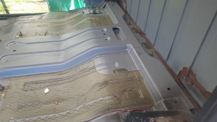

Carpet is out. Headliner is almost out. Little bit of rust to clean up on the driver's side 62cfe73ad818ea59e7930095572ec78d.jpgb23e9d8953916d186d1513c268fedf61.jpg9c5731c17245fb6add3955cfcb464b59.jpg62749c5269b97f2264c3d2b7846b17d0.jpg45ef2d5407d31b6cb2cc7bec8d182ec8.jpg

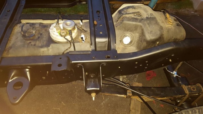

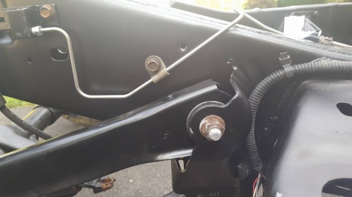

Ok, so I'm trying to figure out how the brake line and gear shift bracket are routed. My old frame had the brake line replaced and routed however was convenient, the new frame may have had a manual trans since only 1 hole is threaded.
If someone could take a look on their truck and send me a pic that would be appreciated.f327fc5eee8099a91f62a5205c215211.jpg410a3fe81534ccfc3aedf30fd84482ab.jpg

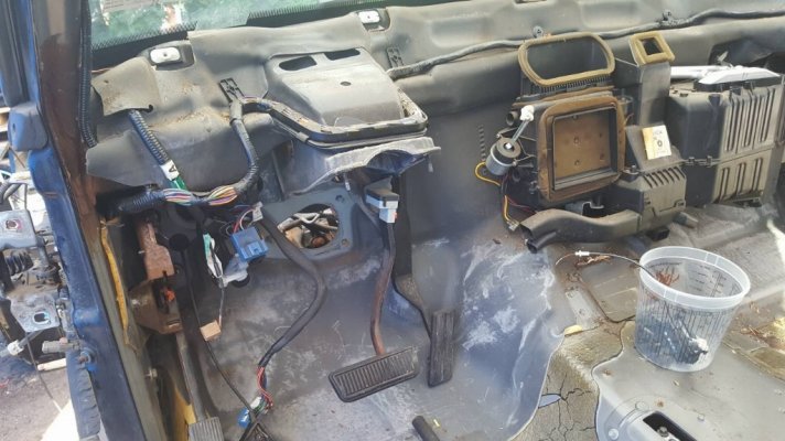

Got the interior completely removed. Going to replace the heater core while the dash is out. Just need to figure out how I'm going to remove the cab so I can clean up the underside before putting it on the new frame.c30c17971674cc54ad3d11b30f5adc66.jpg313475abbeff309c444173956c81afef.jpg
