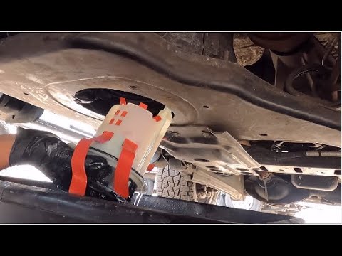

I did the same thing, long story, never do a dual additive at the same time!! Now I use a blue funnel to be extra sure.
Didn't start it.
Took the fill tube off the tank, syphoned off the def. Loosened the pump, drain and filled with 1 jug. repeat 2X. Helluva mess, but $21 vs $1300. What a friggin' rip off!
This guy does 1 of the 3 times I did.
Note: I was going to use Distilled water, but I was worried about the DEF quality error coming on. I use wally world DEF and check it every time with a $20 amazon Refractometer and it is just as good as the $$$ DEF

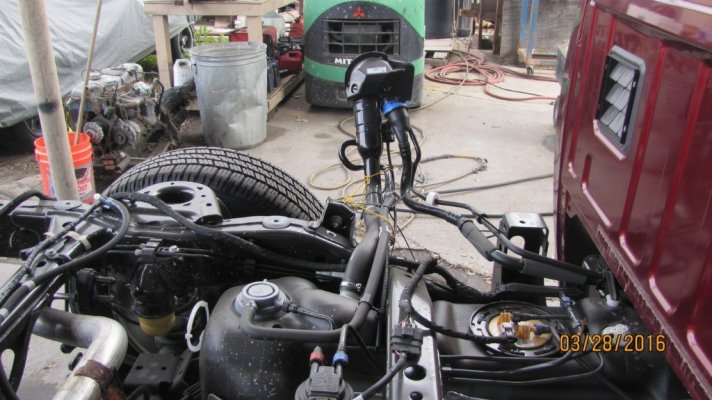

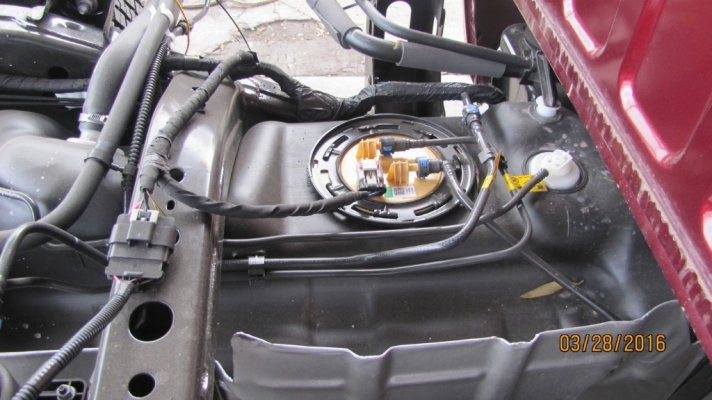

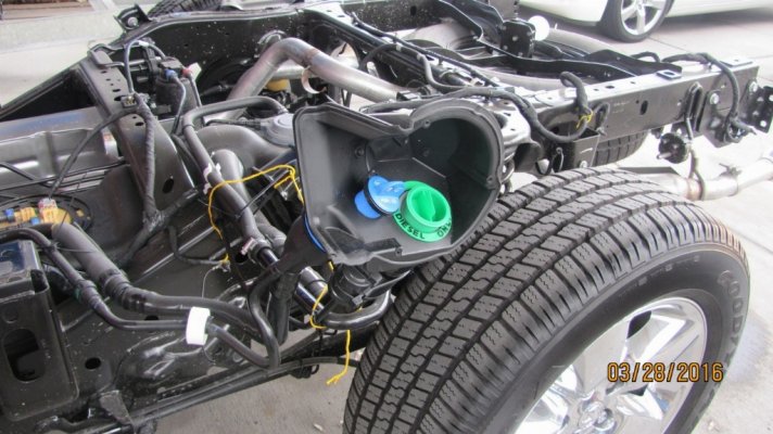

For that amount of money, they would have had to drop the tank & flush
Drop the rest of the plumbing to the exhaust system & flush,
It is not like DEF ever enters the fuel lines
It goes directly to the exhaust system
For the price they charged, you would think that a contaminant was put into the fuel system & then driven until the dash board lit up
1500 ecodiesel
DEF tank is under the cab
