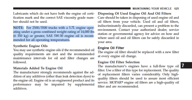

I hope your not planning on running 5W-30 from now on. The reason your oil pressure is higher is because your oil pump is working harder to push the heavier oil. This will most certainly lead to premature pump failure in the long run. Also the reason your truck is quite...thicker oil. Not saying you can't run it just saying unless it was accidentally put in go back to what the truck was designed to run...5W20.
The note at the bottom might interest you.
I've seen this picture a number of times. Do you know what year it's for? Neither my 2014 or my 2019 owners' manual have that statement. My suspicion is it's for pre-MDS engines.

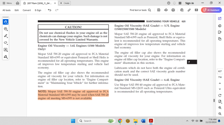

So this is from my 2017 Owner's Manual. The way I read it in this book it applies to the 3.6 but not the 5.7 or 6.4
I am not saying 5W30 should, or should not be used.

It's from the big 700 page printed manual for my 14.You won't have this manual,as you had to phone to get them,they didn't come with the trucks. Supposedly it's in the big manuals up till somewhere around either 16 or 17
