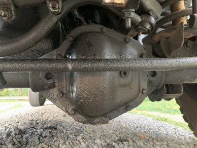

Can you post some pics of the front axle and maybe the casting numbers from the housing?

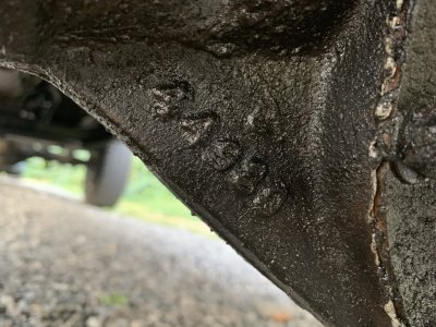

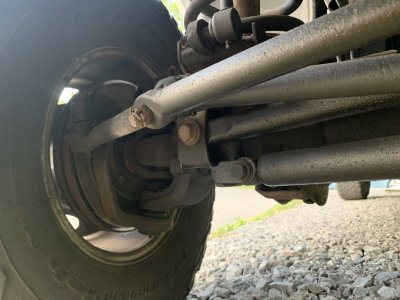

32E7E8F2-DD64-420C-AAA4-E186536727C3.jpeg 9E44710B-0337-4186-AF76-8B87C187FAC9.jpeg 5FE47DA9-41B0-465B-A360-C64E98CC6542.jpeg B2BF8B05-DE53-448F-98A3-DFB44F3B3041.jpeg 5CF661C1-B72D-486D-B09C-0AF5BEA8E4BC.jpeg Not sure if any of these are helpful. I don’t know why I didn’t think to upload these in the first place. Let me know if you need any other views. The bottom left corner of the case has the number “44980” and the bottom right corner of the case has the number “60F”. Wanted to add that in case it was hard to see in the pictures.

That is definitely the stock front Dana 60. Ive been through your issue before with a couple of my customers trucks. They had to use the spacers to install a 15" wheel because of clearance issues.
