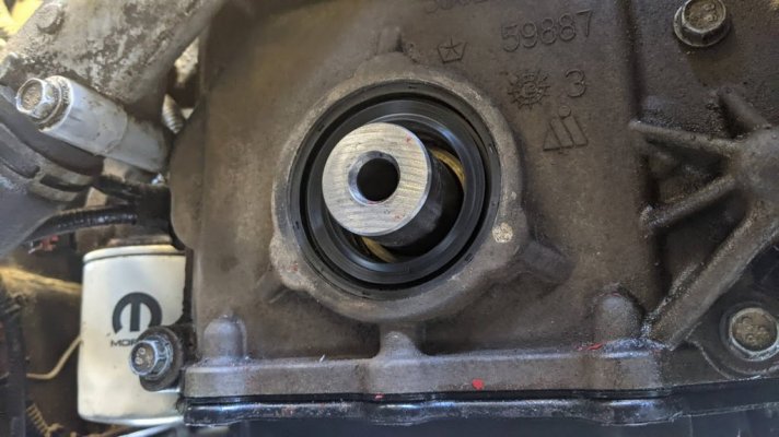

Well my front Crank Seal is leaking, So that was a good excuse to make a new tool :cool:. I sure as **** wasnt paying 100$ for the MOPAR one...
Wife caught me using her Circuit for the stencil and got yelled at :boxing: ... lol...
Will make a brass guide for the bolt tommorow on the lathe.

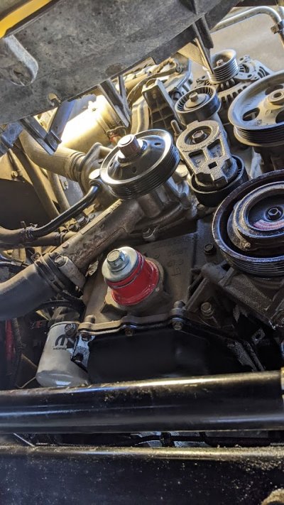

Well it was +5 today so I got it done finally. Had to cut down the tool I made since no one around here had long enough m14 bolts in stock FFS.
So im pretty sure I either smoked to much weed or drank to much beer when I did my cam swap. Somehow the seal got pushed back out while installing my timing cover. lol... NOTE to self! Don't try to install the crank seal before putting on the cover... lol...
While I was under there I retorqued my oil pan bolts. was able to put 1/2 turn on some of them lol.
Once again the 1/2 Milwaukee impact saved the day !
