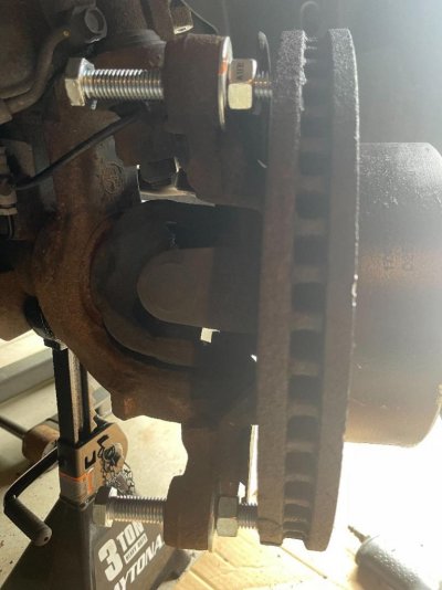

Ok, So tried the screw assist. bent the screws, I'll buy bigger ones, tried heat also but with only map gas would take an hour to get it hot its a big rotor. Ive been spraying it a lot with PB also. This morning before I go get new bolts I'm going to beat the hell out of it some more. So wierd its like something (other then rust) is holding it on) Very frustrating. Burn2k12Ram suggested something with a pipe wrench... not realy understanding how that would work.

Once you get bigger bolts (grade 8 if you can find them) and you crank a bunch of pressure onto the rotor,use your map gas torch to heat the rotor around the hub,once it's warmed up,spray the hub centric with your PB Blaster,then swat the hell out of the rotor with a big hammer and drift/big punch right around the hub.

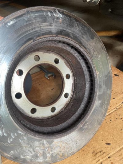

Ok so its off, Hate it when someone posts something and never follows up as far as the results. I used much bigger bolts this time, tighted then three different times in three different locations and it broke free. Super corroded. Really appreciate all the help and support. I never come on here so I am very gratefull at all the responses. Now to the drivers side lol. thumbnail (12).jpgthumbnail (13).jpgthumbnail (14).jpgthumbnail (15).jpg
