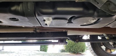

I see even on the last pix posted, the paper sticker is already falling off
I would think that the Tech that claims to have dragged the new tank some distance, would have at least used some sandpaper & some of that can of black spray paint to hide their laziness or deception

So here we are again. Going back to have the "new" tank they installed last year replaced again for the same problem; wont take fuel. Wouldn't a replacement part be revised as to not create the same problem? Anyway, I have an appt for the end of the month.
JLEONARD
JLEONARD
Dec 10, 2016
71
30
Massachusetts
5.7L
UPDATE:
Big AHA gotcha moment while having my tank replaced again. Service manager still denies they put a used tank in last year but, while I'm talking to him, the tech comes in with the part # on the tank he took out. The new one today was a C-series that would replace the C-series they put in last year. Tech reads off a B-series tank right in front of me. The SM's face was priceless as I said "interesting isn't it" with a big grin on my face. He took the hint and shrugged his shoulders. Double checked under the truck too. I got a new one this time.
