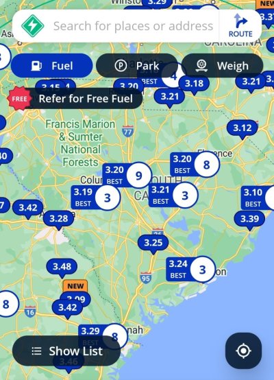

So what I did was using ALFAOBD I recalibrated the BCM. From the factory it had the tank capacity as a 26 gallon tank (actually they had it in liters). So I switched it to the larger 122 liters.
Now every 1/4 increments are 8 gallons of fuel. Why is that important? I travel and have fuel accounts that can save me ALOT of money plus I have a 92 gallon in bed tool/fuel box. So knowing my gauge is accurate at every 1/4 increments, I know how much fuel I'm using out of my reserve when I top off. Plus I can keep track of how many miles I can go to get to that next big discount fuel station to fill everything back up again.
The math:
$3.85 reg price x 100 gallon = $385
$3.15 discount price x 100 g = $315
Savings $70. Every trip that's atleast a two time occurrence equaling $140+
It all adds up. This is why I needed the accuracy. This also proves the effectiveness of having a reserve in bed tank.
The maps below show the current price differences and how it varies alot between my discounted stations and local.
