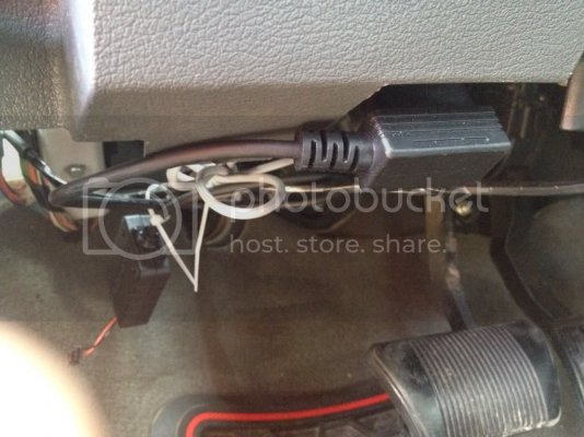

Now to the meat... Got my Quadzilla Vizion gauge system. I had an extra iPhone laying around and thought I'd put it to good use! What it is, is a gauge system that plugs into the OBDII and transmits the readings through it's own wifi signal (responsive and quick as hell) to the iPhone. Since we are a very photo driven forum, I got some shots and video for you guys.
The plug
The set up (key in power mode, no check engine)

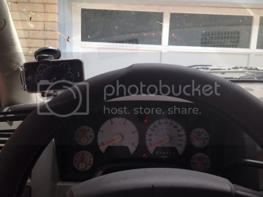

Daily driving set up (EGT, boost, trans temp, rail pressure, and throttle position)

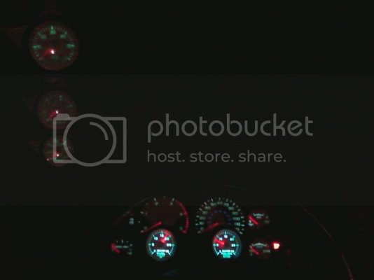

I can watch yours much easier... I got a wide angle of vision and I'm capable of seeing my gauge fairly well even looking forward and just know the standard placement of the needle and what is normal.
Like my fuel pressure if the needle is straight up I know its 15 PSI. If my pyrometer is straight up its 800*F. If my boost is straight up its 17.5 PSI. Where with a digital display you must pull your eyes completely from the road and READ the display. Kind of like my ScanGauge II. Also the problem with digital gauges is they update to slowly.
Give you idea of digital vs. mechanical... Mechanaical gauge will show turbo bark with a violent down swing of the needle where a digital gauge may not even show it.
Just things to be aware of...

Geez I love your set up Schroeder lol
When I run my set up on its analog setting, it's shows all that stuff
