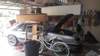

So I have this on my side. Currently that big box is on top of those white cabinets and the hatch is open. I am hoarding parts to rewire and get it back running and the hatch is jammed packed with crap. Now it's also got some speakers and a sub in there...she'll never notice.
She might notice the THUMP after tomorrow though!

Droopie nice fox body. I have an 88GT
