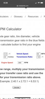

Here is a rpm calc. I don't know the overdrive ratio but jsut use 1:1 for comparison
https://www.crawlpedia.com/rpm_gear_calculator.htm

Here is the rpm difference between stock gears/tires and 5.13’s and 35’s...basically 300 rpm. Thats totally doable in my opinion. A lot of the time I drive around in 5th instead of 6th (I have the 6 speed) because it is much better geared that way for 55-60 mph driving. Doing that raises the rpms roughly by 200, so would not be much more different then switching to 5.13’s for me.
