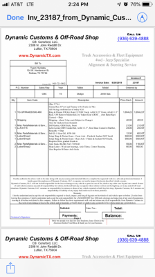

Glad to hear all went well and you were treated good by the shop. That's so important. Customer service is really lacking these days sp that's great to hear...and i think you paid a fair price for the swap
DodgeDude99
Aug 16, 2016
594
283
Oak Lawn, Illinois
Damn $3100, did they even give you a kiss afterwards?
Parts are only $1300 for F&R gears & installs from a place like Alligator Performance. $500 install per axle is normal.
Not too far off once you factor in the fluids and other parts I wouldn’t think of getting, the extra time they spent doing the entire break-in process for me, and the fact that they were extremely accommodating and wonderful to work with. May have cost me a little more than some, but I only had 2 shops in my area, and Im extremely pleased with these guys.
If you are happy then the money doesn’t matter. With a lvl you can clear 37”s with minor trimming depending on wheel offset:
