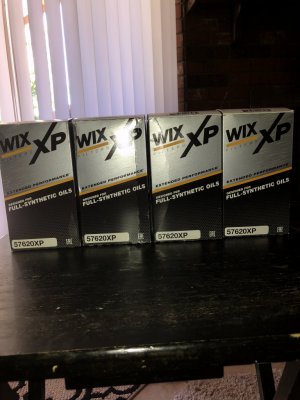

For those that have Amazon and Amazon prime if you use Wix oil filters - keep an eye out they do have the Wix XP filters on sale ever once a while.
They are not the quality or micron rating of the Stratapore - but similar.
Got those for $7 ea - normally $13.99
