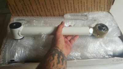

So, I have a 1-2 drop on My 2015 RCSB. I have decided to go lower. I am going for a 3-4 drop.
I have already purchased Core 4X4 upper and lower control arms, and Illicit no cut brackets
I am going to be ordering :
McGaughys 2-4 deluxe kit with drop spindles • leaving the Crown Suspension 1" drop spring in the front
QA1 shocks for the rear
Custom adjustable Panhard bar from Speedway Motors
Hellwig rear sway bar
Thoughts? Comments? Suggestions?

Yes. The Illicit brackets & QA1's both improved how the truck hooked up. I went from consistant mid 1.9 60's w/o those but w/ the same mods on 22" street tires to consistant low to mid 1.8 60's w/ the brackets & shocks on the 22" street tires. I can tell a big difference on the street too.

These trucks cost alot to set a 2/4 lowering kit up right. I have well over $2000 in my suspension but it handles like a dream now. Can hook 1.81 60's on 22" street tires, holds curves better than my Mustang GT did and rides pretty damn good for being lowered. I dd it 100 miles a day. This is the best riding lowered truck I have had w/ its current suspension set up. Now at 1st w/ just the Belltech 2/4 Street Performer kit w/ nothing else done....rode like ****, handled like **** & hooked like ****...lol I hated it. The main 2 things that brought the best out in the suspension was the Illicit brackets & QA1 shocks. If I ever have another 1 of these trucks, I wont lower it w/o those 2. Expecially the Illicit brackets.
