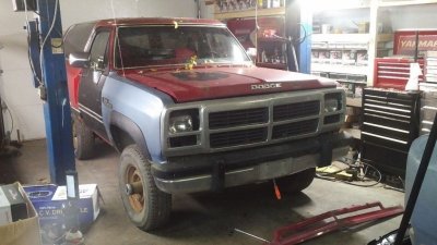

Yup. Here's a '90 with a 93 grille and bumper. Headlights sit low. I think the signal lamp holes are low too. The valance (on the floor) won't fit; the empty gap isn't bad though.
