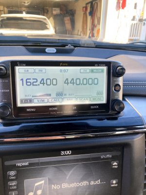

Wow, that's a nice setup...I don't have a radio as yet. I am studying for the Ham Technician license and researching mobile radios, setup, etc. Where did you find this mount? It looks like bolts down in the eyeglass holder?
It is made for that pocket.
Proclipusa.
I think this is the one I have.

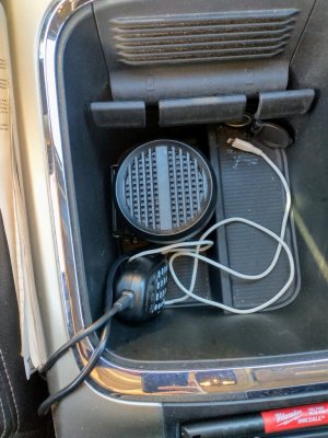

First of all congrats on your ham license. There are lots of ideas on placement of your antennas. Just figure out a way that works for you. Not everyone wants to drill holes in a new truck. If you have a set of roll bars or a headache rack the placement gets real easy. If not you can always go with a good magnet mount on top of the truck. The higher the better. I have my power cords routed through the firewall up by the master cylinder for the brakes. Makes it real easy. The coax run was a little trickier.
Underneath the driver and passenger seats is a small plastic plug about an inch by an inch and a half. I drilled a small hole just big enough for the coax in the plug and pushed the coax through. After fishing the coax up through the slits in the carpet under the seat I routed the coax up under the seats and the console to where the radios were mounted. How you mount your radios is also up to you. I used an old transmission hump cb mount like what they used back in the 70's and 80's. Double sided sticky tape works wonders. Good Luck de KG4BCN

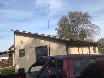

I use the headache rack to mount a VHF/UHF antenna too, actually got the rack so I wouldn't have to worry about drilling a hole in the roof or a magnet scuffing. This way can add an HF whip if I need it later on too.
Ran the antenna cable through a rubber plug under the left rear passenger seat, right at the back.

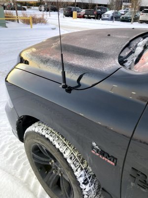

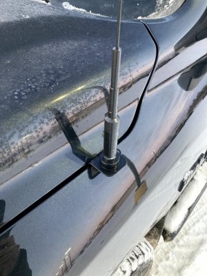

I didn't want to drill my truck either. I used a fender mount for the antenna that uses the stock fender bolt. Yes I would get better antenna performance if it was mounted in the center of the roof but it works great on the fender mount. The radio is mounted under the driver's seat and the head unit is mounted on the dash sun glasses holder. I used the clutch pedal block off plate to run the antenna and power wires through.

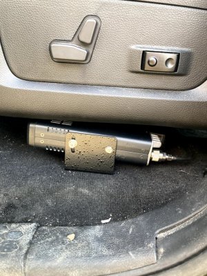

I didn't want to drill into my truck on anything that wasn't easily replicable. For power, I went through the clutch delete plate. I installed my FTM-400 under the driver's seat with velcro. Under there I found a plastic piece under the carpet that I drilled a small hole through for grommet and RG8X to go to my pocket mount antenna (Breedlove EZN STAKE POCKET BRACKET LONG 4 DEGREE TOP PLATE #940). I went this route so I could still park in the garage. I still don't have a permanent location for the external speaker but it's been there for ~8 months and I don't see myself wanting to move it anytime soon.
