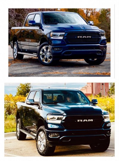

CargoMaxx Springs in the rear.....added about 1.5” to the lift...before and after pic.
