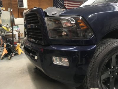

Finally got my HD conversion done yesterday......
Also got the full center console swap done bout 7-8 months ago.....
Pics are before and after of each.....
I no longer have the console shifter......replaced with storage bin from HD truck

How hard is the conversion? This is something I would love to do

**** how did you do this!? Did you do a write up on it?

No I didn't......
But it's pretty easy to do tho.....
Just gotta modify bumper brackets to fit the 1500
Hood and grill are bolt on

I wish my HD had a 1500 hood and grill. It's hard to see over the HD hood offroad at angle.

Love the two gear shifters!

First and last time ever stated.
Spend some time around the Power Wagon guys and you'll hear it more often than you'd think. The 3rd gen HD and 4th gen 1500 hoods are easier to see over on steep inclines. The 4th gen 2500 hood looks good but reduce your ability to see close objects offroad.

Yes I agree....
HD hood looks great and everything from inside truck as well...but I can for sure tell a difference in them (height wise)
