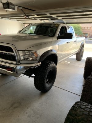

Wow... didnt take long to trash those s 35’s LOL
Truck looks great, man!
Lol yeah. 7.5 months hahaha. Thanks I’m liking these 37’s but will for sure need a regear more than ever

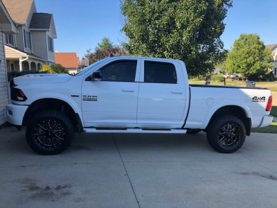

Well I believe i am done with it. Got the new wheels on 20x9 GFX 12 degree offset. Ram wheels.jpg

What gears are you running now?
Bumper cut was my own little project. Its not half bad for free lol. Im running stock 3:73 gears. Wasn’t bad with the 35’s. But I feel it more now with 37’s. Really just when in town and taking off. Off-road still is good. Gears would really get some of my “drivability” back. But she’s pretty much only off-road so that’s a project for after first of the year

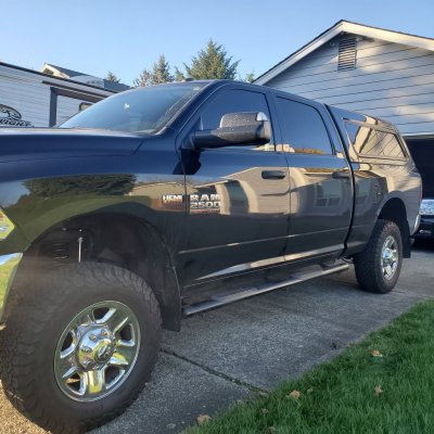

Hi folks. I finally have the 2 inch thuren coil lift with the overland shocks and thuren track bar. Stock tires and wheels for now. Eventually wanna do 35x12.5x18 black wheels. Any suggestions on good all terrain tires and wheels? Don't want the tires sticking out much so offset of positive 0 or 1 would be nice.

+ 18 is about where you want to be for Wheels. Only about 1" out. Those tires look like BFG's. Might want to get your Front end alignment to Thuren Spec's.

I had it aligned with thurens specs at a local 4wheelparts. Yeah they are bfg. According to thuren, bfg all terrains wear faster on these heavy trucks. So I think he recommends toyo and nitto.
