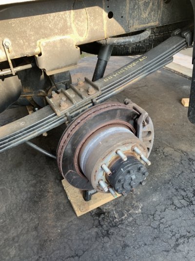

Tossing this kit around again (because why leave anything alone [emoji23])
https://www.suspensionconnection.com/33119-ram-3500.html
Question, will it be good with just the shock extensions? Or go with their own branded replacement shocks? Or go with Fox replacement shocks???
Shouldn’t look to funky on my truck, I’m already running 35’s (285/75/18 duratracs which have the fenders pretty full as it sits stock)

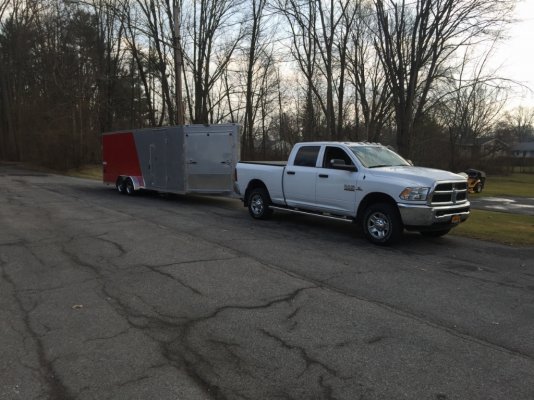

I do pull trailers so I don’t want to get too high of a lift and have to run a huge drop and/or affect pulling the trailer too badly

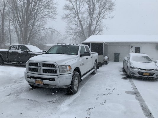

Is your truck a 2500 or 3500?
I'm running a 2.3" level in the front and a 1" block in the rear on my truck with 285/75-18's. Not sure what kind of trailer you tow but I wouldn't go much more then that if you tow often. I am also not a fan of shock extensions personally. I'm sure they will work but I don't like half azzing things and having another variable in the suspension chain.
Gotcha, just saw 6.4 hemi in your signature and that didn't seem right for a 3500

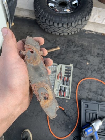

That’s some major corrosion, where do you live?

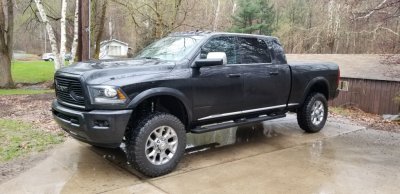

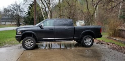

Those wheel wells are screaming for 37s [emoji16]. Fantastic looking truck.Thuren 3" fronts with 1" rear lift springs and king 2.0s all around. Riding on 295/65/20s little over 35"×11.2" or close. Factory limited wheels with 1.75" Bora spacers.
Sent from my SM-G920V using Tapatalk
Yea I think next set when I decide on what rims I want I will be going with 37s and thanks I sure am enjoying it.
