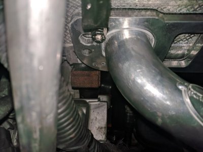

Is there supposed to be an extra stage 8 bolt? Looks like the hole at the bottom of this pic on the driver's side isn't used, but is on the passenger side? I didn't pay close enough attention. Got all the driver side bolts in ready to tighten down and the dipstick tube bent as best I could.
there are a few extra holes, don't know if there's supposed to be extra bolts. Look at your oem manifolds and see if there is a matching hole and if there's wear marks from there being a bolt in it.
Good call... Usually I'm pretty on top of it, but feeling brain dead at the moment. Driver side has one less bolt... I was just missing one uptop... Now if I can figure out where I put that bolt lol

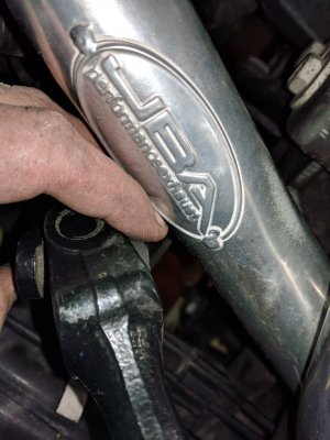

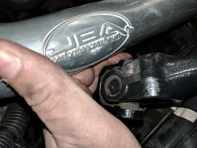

Got the driver side bolted up, still need to mess with the parking brake once the oilpan is fixed since it bolts to the bracket in front of the starter that I had to remove to get the structural dust cover on the bellhousing off. Checked the connection at the steering rod joint... Looks sketchy to me...IMG_20171226_171139.jpg IMG_20171226_171227.jpg

Got the driver side bolted up, still need to mess with the parking brake once the oilpan is fixed since it bolts to the bracket in front of the starter that I had to remove to get the structural dust cover on the bellhousing off. Checked the connection at the steering rod joint... Looks sketchy to me...View attachment 116627 View attachment 116628
You might be okay on steering clearance. Once it's drivable,try making a fairly hard right hand corner while giving it a good shot of the gas pedal.If the engine is going to rock over and hit the knuckle it'll be while doing that.
