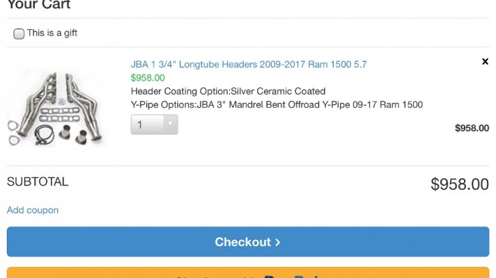

So I think these are the headers I'm going with. Anyone have any experience with these?
