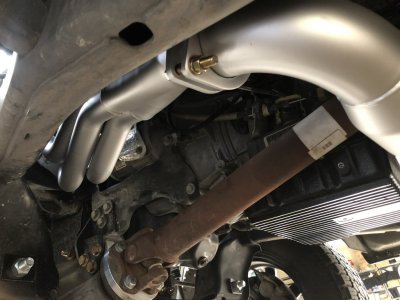

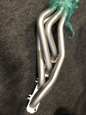

@Jeremiah DeVries :welcome: to Ramforum. It was mentioned above by Nick, but I will reiterate. In addition to those LT headers you will need a custom tune too (I use Hemifever's 93 on a Diablo Trinity T2). As for powerful sounding, but not obnoxious, I run ARH Headers (1 3/4) with high flow CATs (at Matt's recommendation), I ceramic coated them as @Pull Ya suggested, and matched the headers to my existing Magnaflow Cat-back exhaust (single exit). I run a 3" pipe from the Y-pipe back. No cabin drone, insanely powerful and throaty when I smash the pedal on the right. ARH has fantastic fitment. I went ahead and put on Remflex gaskets and Stage 8 fasteners, but they are not required. Headers, the tune, the exhaust... this is not cheap but will pay HUGE dividends in your truck's performance and your enjoyment. That much is guaranteed!
