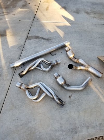

My own personal setup I did aFe 1 3/4 primaries, 3" catted y-pipe and something unique to aFe they include a 3.5" downpipe that connects from the y-pipe to the muffler. If I could do it again I'd go 1 7/8's simply because you can never have too much horsepower. But going from 3/4 to 7/8 won't happen unless I had to.
