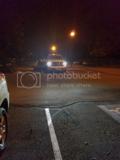

Thats crazy, I had the complete OPPOSITE experience. Ordered my Opt7 on amazon and it came with everything i needed. I actually notified them about a part I thought I was missing and they sent it out within 72 hours and did not question it at all. It turns out I actually had the part so it was my fault and did not need it after all. I communicated through amazon and it was a very responsive experience.
The installation: I took both headlights out without a problem. 2 Bolts on top and then the plastic piece you pop out through the fender. After removing the headlight I opened the dust cap and took the old bulb out. I put the OPT7 Leds inside of the headlight and sealed it. No issues at all. The headlight bulb swap took max 30 minutes. :naughty:
Anyways enough reading here is a visual: OPT 7 Led bulbs on Quads. No codes thrown and flicker free.

They look great!! I'm guessing the dust caps still get left off either way?
