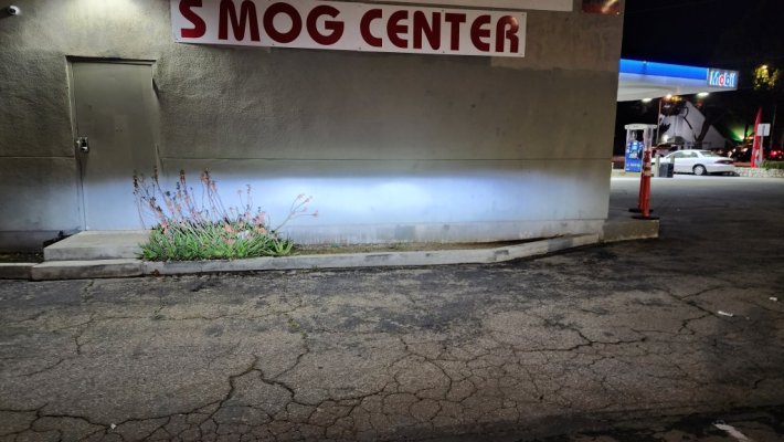

I hear you when you say you don't want to go LED, and you don't want to annoy or endanger anyone with super brights. I don't recommend LEDs in halogen housings, as the reflectors overly spread the light.
For reasons, I decided to do just that, and see if it's terrible, as I couldn't see with stock bulbs, and wasn't up to spending $900+ for quality aftermarket headlights. I spent $80, got LED for highs AND lows, adjusted them, and then had my wife, in her little compact car drove in front of me. She said they were bright, but not blinding. Here's a picture of the cutoff. You can see that there isn't a bunch of spill over the top.
If you are interested, I can provide make/ model of the LEDs. Our than that, follow Mikeru's suggestion of aftermarket headlights
NOTE: if you are lifted/ leveled DO NOT DO AS I DID. you would end up adjusting the lights so low you wouldn't see them
