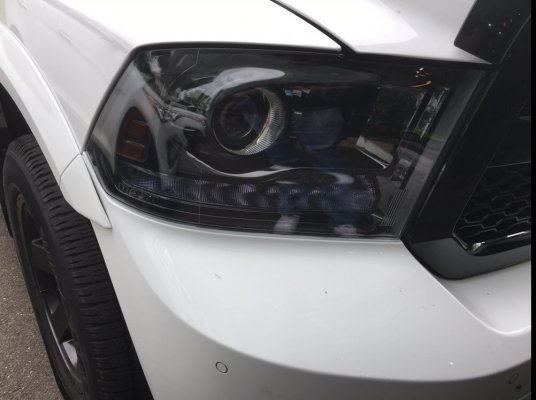

Order through Retroshop and do what I did..

Wow those are awesome looking. What exactly did you have done pgr1990?

pgr1990
Jun 24, 2016
490
352
3.0 EcoDiesel
I had Retroshop build OEM RAM headlights with their “black out” option and diode dynamic switchback boards. I added the HIDs myself.
If you send in your own headlights it’s really not that expensive.
