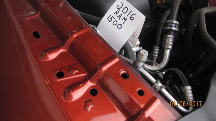

adjustment holes for headlight adjustment
Do not try adjusting without a wall or something in front of the vehicle
Make minor adjustments
I suggest watching a YouTube video on your vehicles adjustments

Is there an individual adjustment for high and low beams or just one adjustment for both ? I put the alpharex headlights in and need to adjust.
They are tied together. There is no individual adjustment for them.
