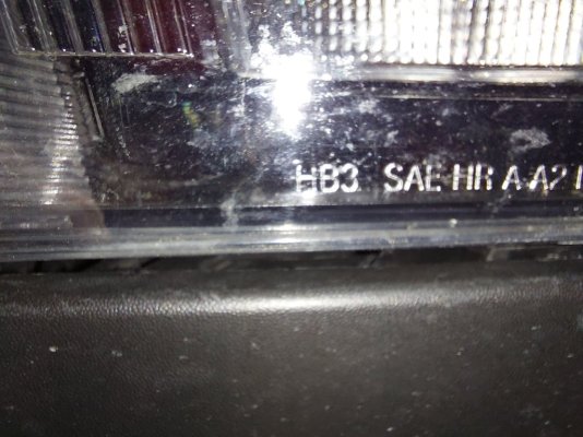

Bulb sizes are stamped right into the headlight lens on the bottom. No need to remove the bulbs. If they don't say 9005 or whatever, they'll say hb3 or something similar. Every housing I've used that had replaceable bulbs had been this way.
Oh, well thats great advice haha! I did not notice that - I'll have to check it out tonight.
Thanks, that's a fantastic tidbit that would have saved me from initially buying the wrong set of bulbs, and maybe others, too. :cool:
