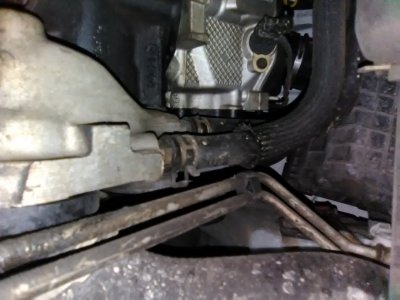

my question: Are these two hoses ((pics will be included)) that run from the engine directly to the firewall, my heater core hoses? i do not want to mess with anything until i know 100% what i am dealing with.

If those are coming from the water pump then yes. It's hard to see pics.

here is an undershot of the above photos, i think that may be the water pump but i am not sure as i am not a mechanic how ever i do like to learn things about my vehicles and work on them myself.
if that is the water pump and those hoses DO lead directly to the heater core and i can undo them to begin cleaning. i will.

Yes, that's the water pump. I suggest to flush it right from the fire wall, just get a 10' piece of 5/8 heater hose cut it in half, pull off the two hoses on fire wall, attach 5/8 hoses to the two fittings, one to a bucket and other to your house water hose, flush it both ways. Make sure to poure some coolant (G-05) in the heater core after you reattach bottom hose when done. Then bleed the system by loosening the allen plug that's located on the drivers side top radiator hose, on engine block, just loosen it a few turns till you see bubbles, then tighten when bubbles are no longer, you may have to do that a few times to get all the air out. Good luck bud, keep us posted.
