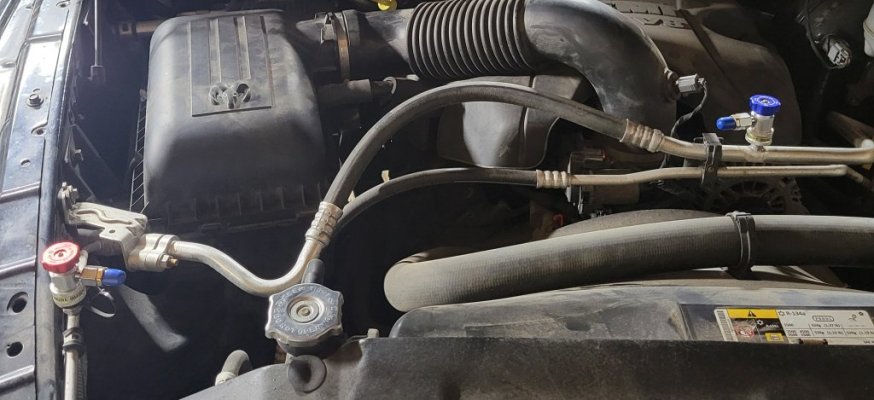

Question. Bought the AC gauge from harbor freight. My problem is the couplers are marked high and low pressure and in my truck they fit on opposite. High on low and low on high. I always thought larger diameter pipe is high side. Was I wrong?

Blue is low red is high
The pipe that blue is mounted on is larger diameter then the red
The larger diameter is low, (suction), side.
