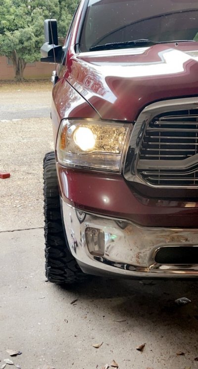

sooo.. i was trying to add my led headlights in Alpha obd and somehow i killed my rear running lights
they are the factory hologen bulbs. the trailer lights still work so i went to the auto parts store bought a trailer harness and some bulb connectors and i am currently running my rear lights from the trailer plug.
can someone please help me un f*%$ whatever i messed up. no i didnt realize we could save the factory settings beforehand so i cant just reload it.... can i reload someone elses factory settings and go from there or? im lost i read through almost every setting and cant figure out what i did… I also got a ticket for no running lights that same night because I didn’t notice it wasn’t working. The brake and turns work just not the running lights D83BCAF4-5364-4029-A9E6-EFBF7313AD7D.jpegD067525B-34DE-465A-A2CB-E5F68965064D.jpeg
