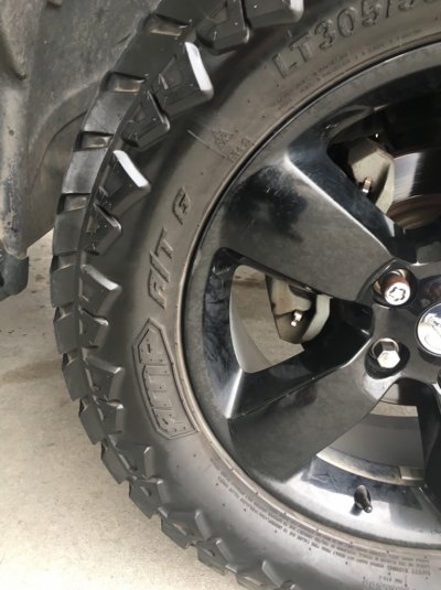

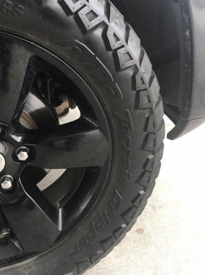

I still have some time to decide on tire size because my factory tires probably have another 15 to 20k miles to go. When I was filling up the other day another ram owner was parked next to me and he had a 2” level with factory 20’s. Tires were amp all terrains 305/55r20. Looked about perfect to me so now I am leaning toward that size. Still pricey compared to the stock size!
Took a couple of close ups of his setup:

We're you able to ask if it had any rubbing at the size?
Didn’t think to ask if they rubbed. If they did he probably would have said something cause we talked for a few minutes about the tires. He was really happy with them and was in his second set already.

hemi 5.7 with I2 tune
with them that close to body panels, could he go off road? Seems a bit tight.

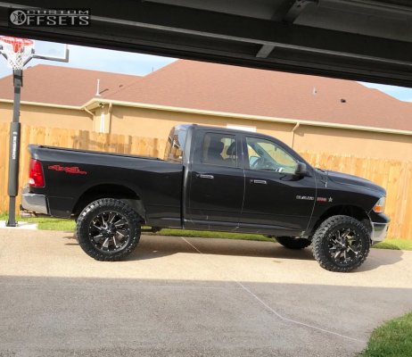

Hows everyone's CV angles on 2.1 & 2.8. I've seen a few At 2.1 that look perfectly parallel
This too I'm concerned about. Whoever has their bils set at 2.8 and pics of their cv angles, please post. Thanks!
Mine at 2.8:
