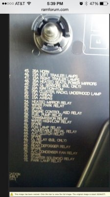

There is probably a fuse after the flasher to keep a trailer short from effecting the truck. Here I found this check fuse #47
Here's the box diagram I found one. http://www.ramforum.com/f54/need_2003_ram_fuse_list-12565/
Edit: sorry for being so persistent but I'm 95% sure this is your issue I have had the same senario happen to me many times

Fuse 47 is good. From what I understand everything for the trailer is on a totally different harness. It doesn't share any fuses or flasher relays.
