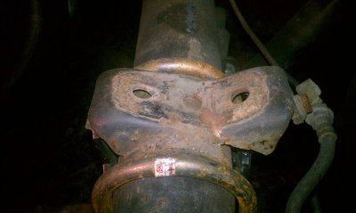

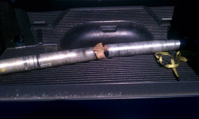

Yes. I learned the hard way unfortunately
Sent from my Galaxy S3 using Tapatalk 2
