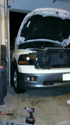

(I'm attaching this picture while my new heads are getting finished...had the harnesses and ballasts wired up and took the last headlight out of the box only to find that UPS had absolutely destroyed it.)

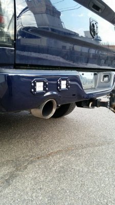

I tied mine into reverse lights

Love that setup! Makes me want to match my housings to my bumper now!
