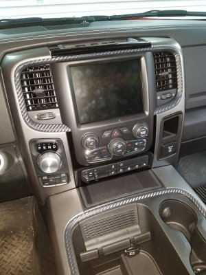

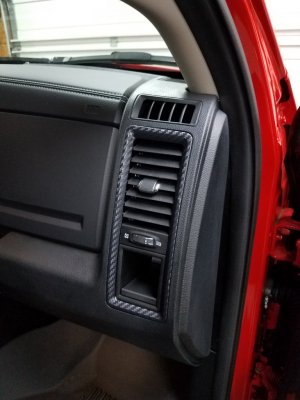

My dash has chrome trim around the ac vents and around part of the dash. I cannot seem to find one of those anywhere but I'm thinking maybe they only made them for the Sport models. If I change the dash bezel to a non chrome trim one, then my left and right ac vents by the doors will be different than the middle.
you could always paint the chrome rings so they all match or even vinyl wrap them. On my sport I vinyl wrapped them (especially the chrome ring on the console to stop the sun reflecting in my eyes)20170409_152203.jpg

Thank for the idea. Do they sell a kit to vinyl wrap them? Or did you take it somewhere to be done. So you just removed all the chrome trim pieces, wrapped, then reattach? Do they come off easily. I don't really need to do the console as I'm going to pack it up for now. And is the vinyl removable if I want to go back to stock?
quietpeen
Jul 14, 2010
25,443
3,913
2021 TRX
Hellcat
the chrome on the radio bezel doesn't come completely off(held on with plastic welds)
for the vents by the doors you can pop the whole assembly out of the truck, then they can be disassembled down to just the chrome ring.
I bought sheets of vinyl off amazon and just cut as needed and applied. Yes it can later be taken off later on.

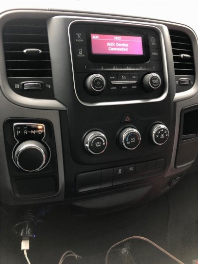

Perry
Sep 21, 2017
23
9
This is what’s in my regular cab.
