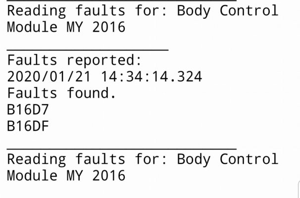

I keep getting these error codes. Where do I start? Bulbs are working. Sockets were working and now are bad. I believe fuse is good because wires are testing hot at tail light harness. Only Led lights are in high beams. Any help would be appreciated. a25599e64f6caa4668ffb6a36e93bf55.jpg

Could be wiring, or the BCM. There should be a - then 2 more numbers after those codes to show which circuit and what fault is being set.
Both tail lights share the same ground circuit so that would be a good place to look. Do all the brake lights,tail lights, signal lights work properly? Any flashing fast.

Thanks for your reply. I actually found the problem. Hopefully. I had a bad bulb. Doesn't make sense to me. I replaced both bulbs and it works. Guess i will see if it stays that way.
