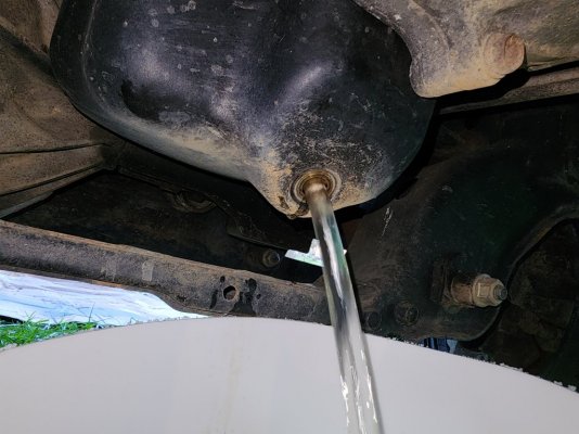

I started taking it apart, got down to the timing chain area, went ahead drained the oil also. To my horror, but not really surprise, this comes out the oil pan for about 6 or 7 seconds before the actual oil came out. I could do nothing but take a photo & remorse for a few moments over what was happening.

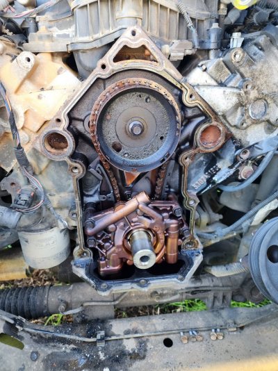

I left the drain plug off after it all drained out, and after taking the timing cover off. The timing chain looked nice, the tensioner doesnt seem to have skipped a beat anywhere. So the no start, free spin with occasional pop through the tail pipe has to be from either a blown head gasket, or what I REALLY hope it is not, a cracked block I guess right? Its obvious water settled down into the pan over the 2 month sitting period. So I am at the point where I have to figure out what is exactly going on before dropping 2k on a used motor assembly.
I noticed that when I put some water into the water pump holes, obviously it leaks out of the plugs but it also trickles out of the oil pan drain hole when I do this. Thats squirting a light little stream of water into the water pump holes on both sides, does the same thing = little trickle out of the oil pan drain hole.

Another mechanic chiming in here (dad is also a 50+ year mechanic). Going through winter with a coolant leak, you should've been topping it up using coolant/antifreeze instead of water. What was stated above is 100% accurate tech, you overheated it and *most likely* warped the heads/popped the head gaskets (not 100% of the time but very likely). As you said, it was probably already frozen before that. Then after you parked it, the water you've been topping it up with froze in the block (again) which pushed out the freeze plugs and cracked the block. If it ONLY pushed out the freeze plugs, you wouldn't be getting water out of the oil drain plug when sticking a hose in the water pump holes, it would only come out the freeze plugs. Water galleys don't go into the crank case. As stated above, that motor is done for.
