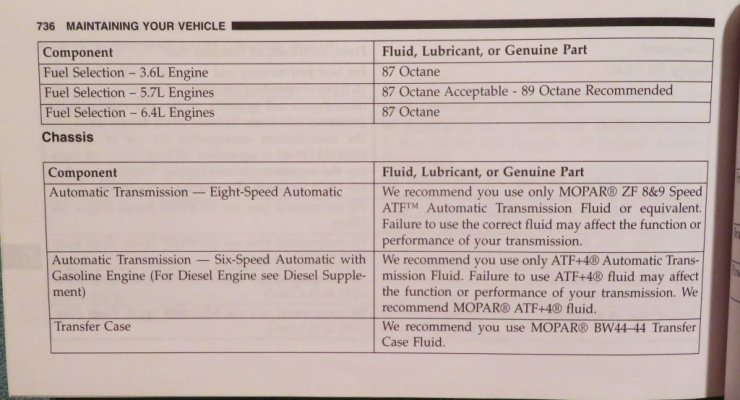

Seeing as how you haven't checked your owners manual ,you might want to read this page.This is from the 700 page printed manual for the trucks

I finally got around to checking my 700 page printed manual,and it looks like they do differentiate between the 5.7 and 6.4,at least in this manual they do.

Still waiting for this picture showing where your owners manual specifies 93,you must have the "special" manual,as every other manual is like this one and says 89 reconmended but 87 is acceptable. BTW: 93 Ron is more akin to 89 octane in the US and Canada,are you sure you don't have the 2 mixed up
